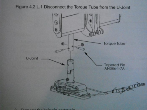

4.2.I.1
U JOINT AND FWD CAPSTN
U JOINT LINKS THE CAPSTAN TO THE RUDDER PEDAL ASSEMBLY.
ASSEMBLE CAPSTAN 4.2.C.
BOLT CAPSTAN BETWEEN UPPER AND LOWERR BELL CRANKS.
INSERT ASSEMBLY BETWEEN UPPER AND LOWER RETINING PLATES.
U-JOINT IS ATTACHED TO THE TORQUE TUBE USING, TAPER PINS.
FIG 4.2.L.1
