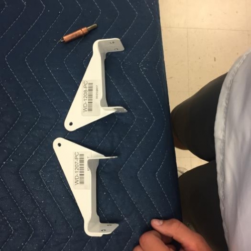

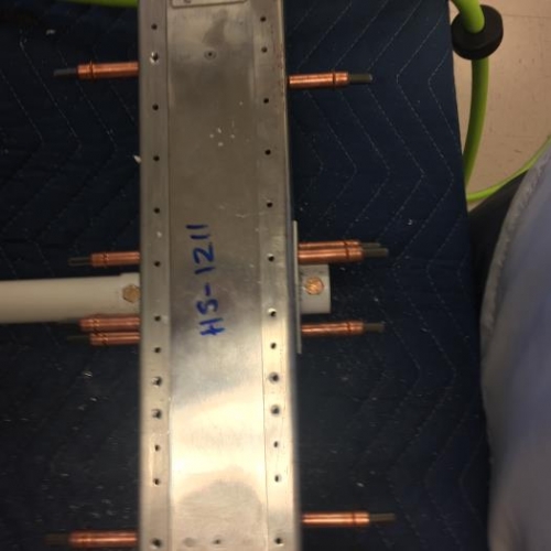

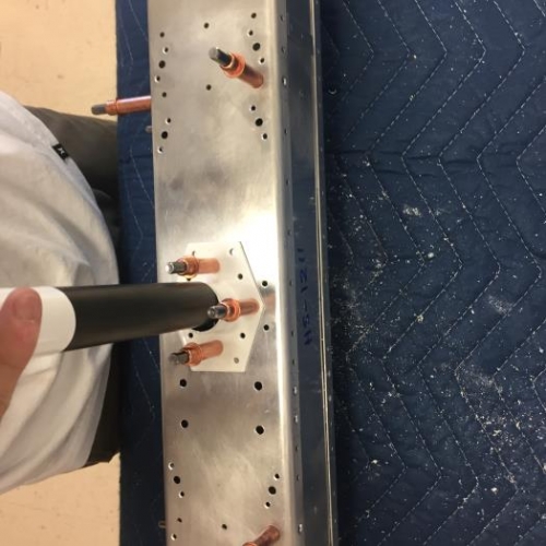

Brief Description:  Clechoed and matched and final drilled
Clecho HS-1202 abd HS1203 to HS1212. Cleco WE-1207 and WD-1208 to HS1202 and HS1203. FInal Drilled WD-1207 and WD1208. Removed upper and lower horn and debbured. Final Drilled WD1222. Aligned We-1222 to HS1202 and HS1093. Matched Drilled 1222 into WD 1222.
