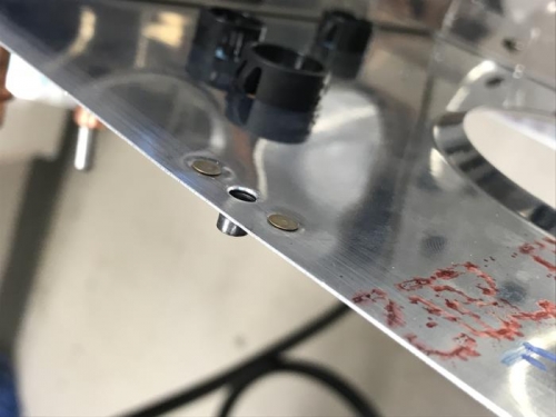

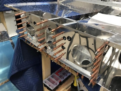

Dimple the four sets of nutplate attach rivet holes in the F-1207B Baggage Bulkhead. Dimple the nutplates, then rivet them to the F-1207B BaggageBulkhead. Cleco F-1207B to the Assembly. Did not rivet yet.
Deburr F-1288.
