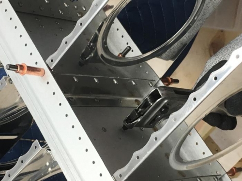

L Wing Rib Final Riveting
Riveted the final main ribs to the spar with the LP4-4 rivets. Worked on stall warning assembly. Stall warning kit came with incorrect washers which caused a clearance problem for the moving tab.
