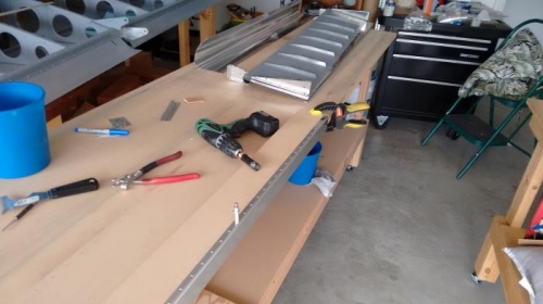

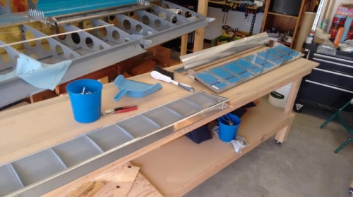

Begin disassembly and cleanup / deburr, prime, dimple, CS all parts for right aileron.
Entire aileron was completely flat when I took off the weights and board. Rear wedge is the key - keep it straight and work from the center out when cleco / riveting.
Got everything disassembled. CS doubler plates and spar.
Installed new CS cutting head/bit.. Made a big difference!
Taking it all apart
Taking it all apart
