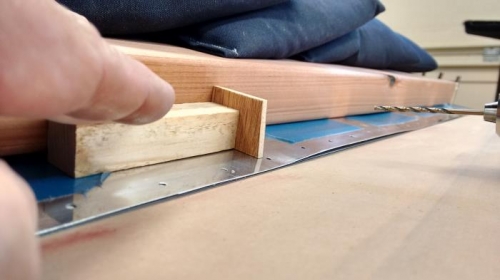

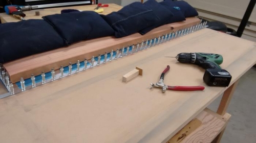

Brief Description:  Place and drill trailing edge wedge
installed trailing edge wedge. Double checked placement.

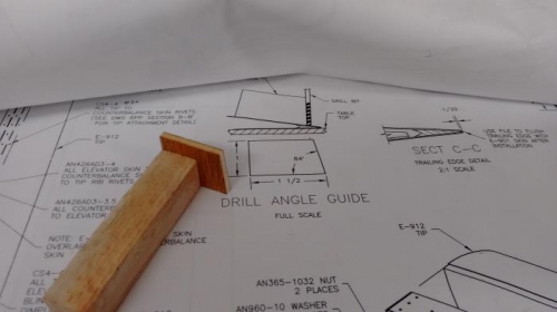

Re-build drill angle gage - original one was used for trailing edges of elevator and rudder.
Started in middle and worked my way out each side - drill through to table and then cleco to table.
Skin is nice and flat now.
new drill angle gage with 'handle'
Gage in place - not gaps in skin
all in no gaps
all in no gaps
