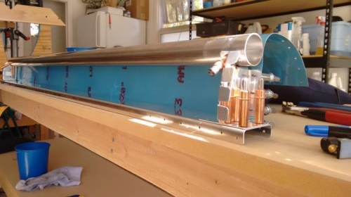

Brief Description:  Drill holes in CB tube for R aileron
Drilling second set of holes in SS CB tube for right aileron. Based on trial and error with left aileron I should be able to keep things lined up and not introduce a twist to the spar.
One false start. fist two holes introduced a twist when I rotated them to the bottom holes.
Turned tube around, kept first holes on top, marked holes on bottom and drilled one at a time.
Turned out well. One basic problem is that the top and bottom holes are somewhat offset and it moves the SS tube slightly (1/32") left or right.
clamped and weighted for marking
