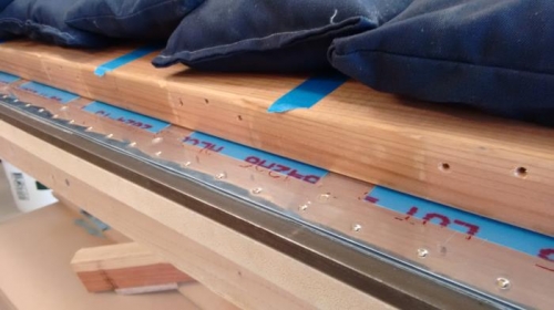

Install rivets, tape, back rivet, finish trailing
Used rivet tape to hold rivets in place, turned over, weighted down, and did initial 1/2 set.

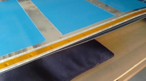

Turned over and used mushroom head to finish rivets.
Turned out pretty darn straight.
Rivets taped in place
Back riveting
All in
