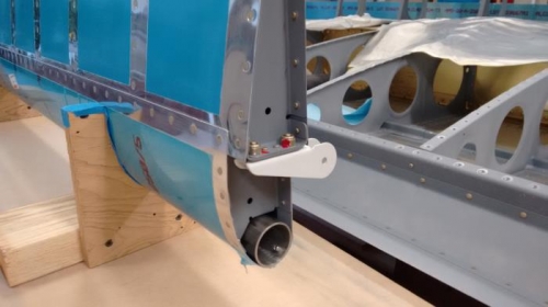

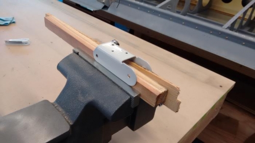

Brief Description:  Drill out aileron brackets 906 & 907 and install o
Drilled bracket holes and spar holes. Final size for AN3 bolts is #12. Step drilled holes (starting #30) to #13 and used #12 reamer to final size. Torqued. Marked with nail polish (torque marker!)

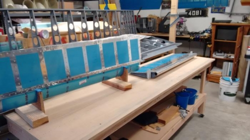

Both ailerons complete!!
Drill hole in bracket
Nut Bolt Washer and torqued
Both ailerons done!
Both ailerons done!
