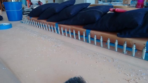

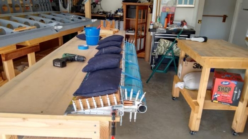

Repositioned aileron top up. Put board and weights on top, installed wedge. All is nice and flat.

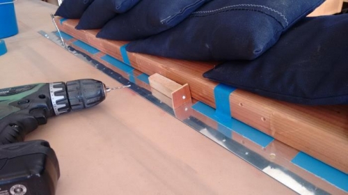

Drilling with angle gage.
All holes in and trailing edge straight.
Disassembled and started deburring.
