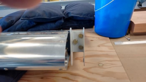

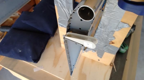

Brief Description:  Drill and install A906 & A907 brackets
Drilled bracket holes and spar holes. Final size for AN3 bolts is #12. Step drilled holes (starting #30) to #13 and used #12 reamer to final size. Found bag with aileron hardware and installed bolts / washers / nylock bolts. Torqued. Marked with nail polish (torque marker!)
Double checking show I used the wrong net on one bolt and wrong washer on two bolts. Thin washer is for nut plate bolt. shorter nylock nuts are used later. NOTE TO SELF DOUBLE CHECK WITH PLANS
