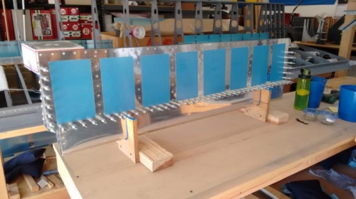

Brief Description:  Make saddle fixture for aileron skin riveting
Found the perfect scrap of plywood and made two saddle fixtures.
Trimmed and sanded to keep as smooth as possible.
Good tight fit! Should make putting the nose skin on the left aileron much easier.
