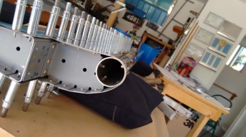

Riveted 905 ribs to spar assembly.
Clecoed top and bottom skins to ribs
Clecoed nose skin to counterbalance tube and spar.

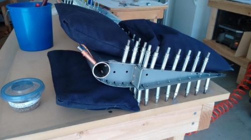

Blind riveted nose skin to counterbalance tube. Per suggestions in directions I used a hammer to tap the edges of the blind rivets more flush with the bend of the skin (tight radius) - turned out well.
Everything clecoed and ready to pop rivet
"Popping" first rivets
All in, looks clean
