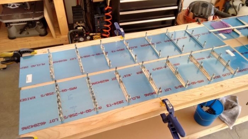

Re checked skin to spar orientation and found two skins upside.
RE-RE-CHECKED test fit to spar to verify (again).
Drilled right skin stiffeners
Pulled blue plastic off inside skin and marked outside strips where rivets will go (soldering iron)

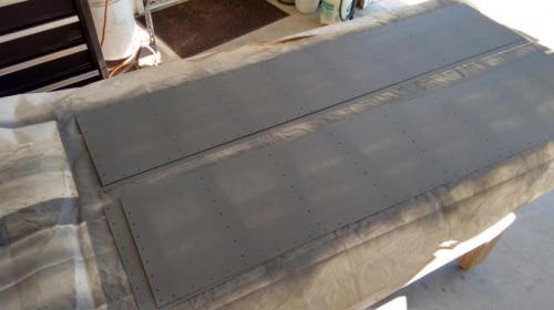

Scuffed up inside skins and primed.
Stiffener to skin
Stiffener to skin
Skins inside primed
Skins inside primed
