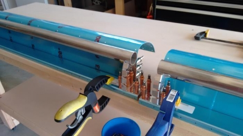

Brief Description:  Fit mark and drill A909 counterbalance tube

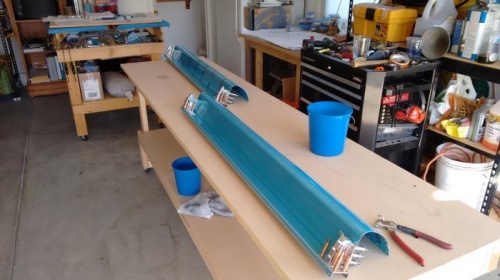

Cleco ribs to spar. Cleco nose skins upside down to nose ribs.
Marked counter balance tube (heavy stainless steel) with half size sharpie pulled top off body and it fit under tube between spar and rib.
Set up drill press and leveled and lined up tube to drill.
