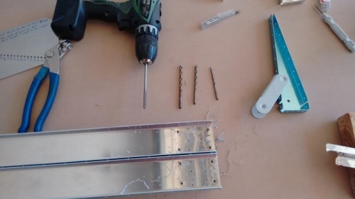

Brief Description:  Begin Aileron layout / building
Found parts for first few steps and laid out to get a good visual of 'what goes where'.
Laying out and doing both ailerons at the same time.
Drilled out spar and doubler for A-904 ribs and nut plate. nut plate is for AN 3 bolt. Drilled out in steps; 30, 19, 13 and then reamed out to #12.
Test drilled scrap to verify.

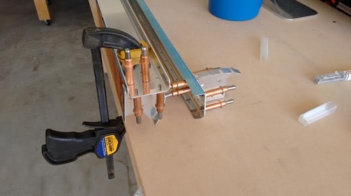

Drilled and clecoed A904 Ribs to spars
Verify locations
Verify locations
Drill out nut plate AN3 bolt hole in steps
Drilling out holes for nose ribs
