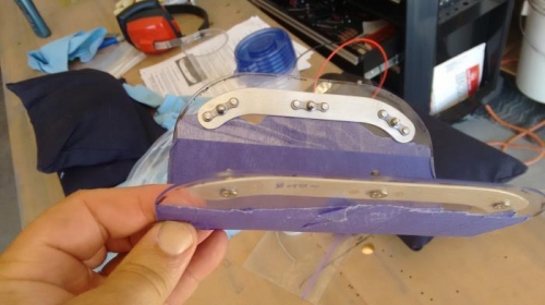

Brief Description:  Clean and test fit lens attach brackets
Cleaned up edges and determining if double stick tape (provided) will hold brackets in place. VERY small amount of double sided tape to work with.
Decided to test fit brackets to see where best place for tape would be. Duckworks website mentions that some builders use proseal. That, or some other flexible epoxy like stuff, might make a better bracket stabilizer and provide some crack protection around holes??
Also researching methods for working with Plexiglas. Drilling - countersink back of hole (when drilling small to larger). Use single blade/surface CS bit NOT three edge bit.
Holes in good shape, CS good.
