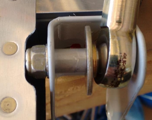

Manual Reference:  Push Rod attach
Brief Description:  Pushrod attach bolt nut not fitting
When trying to install aileron pushrod on aileron side the attach screw needs to be cut down for clearance. Cut down screws but nut would not fit correctly in gap provided. Measured, read plans, almost called Vans to tell them there was a major problem, then I noticed the part number call out MS21083-N3 nut is a 'short' version of AN365-1032 nylock nut. Have no idea how I missed it but it fit MUCH better
No room with washer
No room with washer
screw not problem
screw not problem
Smaller nut fits better!
