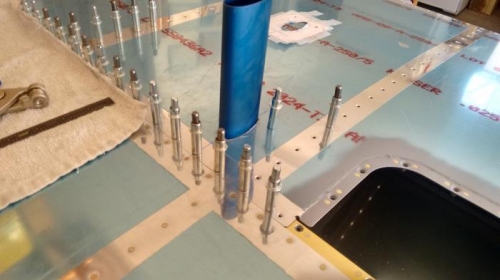

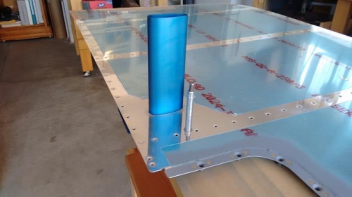

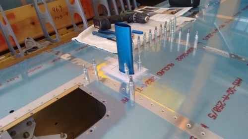

Manual Reference:  Avery Pitot Mast
Brief Description:  Fit pitot mast and drill rivet holes
Used template to mark and drill holes in skin (aft side of mast). Held mast in place and marked holes in mast. Removed and drilled out holes on bench. Reinstalled, clecoed, and then used main spar holes to mark and drill forward holes in mast.
Removed again, cleaned up holes, counter sunk mast plate and dimpled aft holes in skin. Reinstalled and clecoed in place on skin (after removing skin from wing. Discovered that mast was not properly aligned. Decided that it was out of alignment enough that I ordered a new mast (cant un drill holes!
