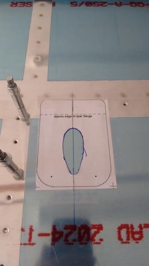

Brief Description:  Mark and drill out pitot tube mast hole in wing

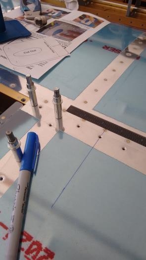

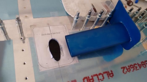

Measured and marked bottom wing skin (one bay out side aileron bell crank) , taped template, and drilled out hole for pitot tube mast. Used two different sized step drills to remove big parts of hole. Finished up with small cutoff wheel (dremel) and cleaned up hole with small scotch brite wheel
Centered on middle rivet
Template in place and skin marked

Hole drilled out and shaped
