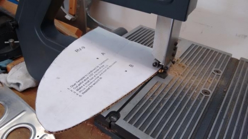

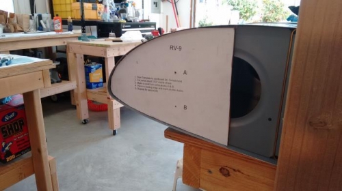

Landing light bracket is held in place by four (nut plate retained) screws. Paper template is glued to cardboard, cut out and then used to mark holes in ribs for drilling. Used thick cardboard and the rough cut with exacto knife. Then used band saw to carefully trim, mark, trim, mark, trim... until tight fit was achieved. Once I had the best fit I could get I used hole punch to mark ribs for drilling
Outside first fit, then mark for trim
Trimming with band saw (great idea)
Final fit and holes marked
