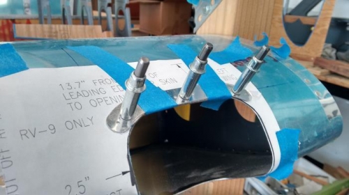

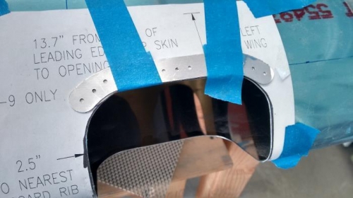

Duckworks install
Drilled holes for lens install
Replaced template and used hole diagram to place lens backing strips. Used strips as guide to drill out holes
Template and bracket in place
Drill hole, cleco, drill, cleco
