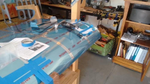

Brief Description:  Moved wing and marked for landing light cutout
Needed to turn over wing for better access but had to be VERY careful not to bend / mangle stall warning tab. Found 2x4 with channel cut out (fence project) and used it taped to leading edge to protect tab. Used rope to steady wing as I turned it p and over ( one man operation) and with quite a bit of jockeying (wing root spar is longer the distance between upright posts) get it safely turned. Removed boards - it looks like they could crease skins if too much weight is present. (Maybe smooth them down to leading edge round shape??
Measured and placed cut out diagram on wing. Marked wing and removed template - ready to cut!

Measured and marked
Measured and marked
Ready to cut
Ready to cut
