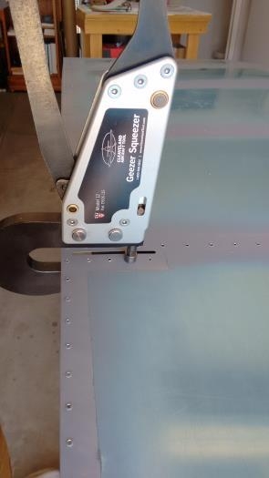

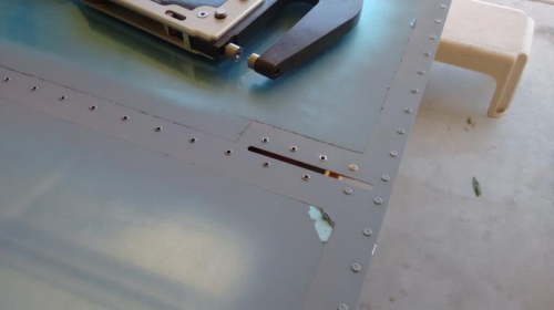

Brief Description:  Remove and re dimple #6 holes in access plate
Noticed that the inspection plate screws were not seating flush (when marking / cutting / fitting pitot mast) Removed and reset dimple with Cleveland dies (better dimple - deeper?)
Also noticed one row of AN3 rivet holes that did not get dimpled on bottom skin. dimpled them.
Hand Squeezer Fits
Hand Squeezer Fits
All Dimpled
All Dimpled
