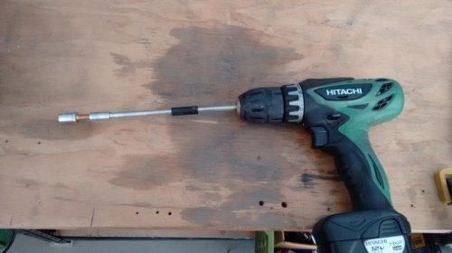

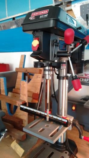

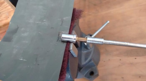

Received new rod ends and rod tubs (steel). Sanded down inside of tubes and needed to sand down OD rod ends so they will insert into pushrod tubs. Tried hand drill and reamer extension. Somewhat effective. Better results using drill press.
Tried using drill
Tried using drill
Sandpaper/Scotch brite held by vise
Better results with drill press
