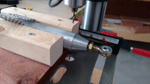

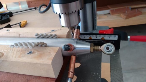

Insert. rod end into pushrod tube and used drill press to drill six equidistant holes. clecoed in place.
First drill with drill press seems to pull rod end into tube slightly.
All holes drilled.
One bit broke.
small tubes drilled straight through
Set up for drilling first hole

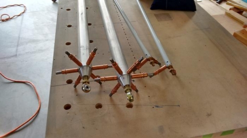

Last hole in large tube, clecos
All four tubes done.
