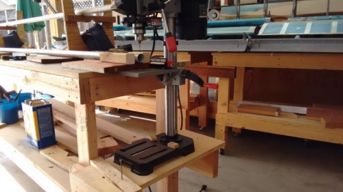

Built temp shelf for drill press do it was more even with bench. Now pushrod tubes wont be suspended so high off bench when trying to drill holes for rod ends.

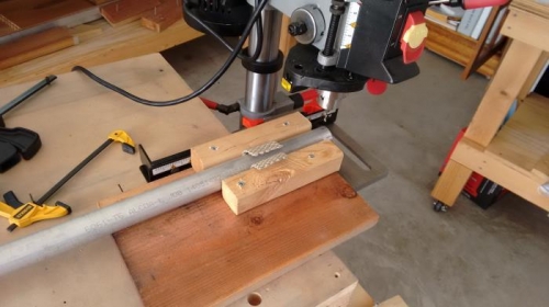

Also built pushrod tube holder to keep pipe aligned when drilling.

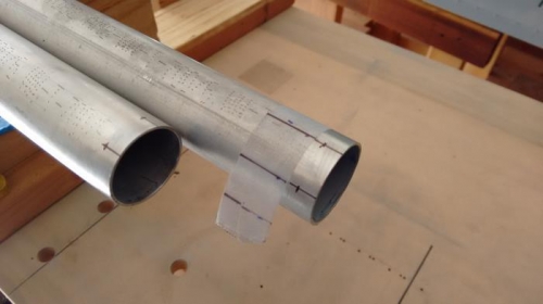

Re measured and marked tube ends for drilling.

Shelf to lower drill press
Tube holder jig
Tube holder jig
Tubes re marked
Tubes re marked
