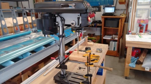

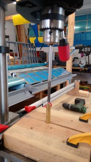

Brief Description:  Ream out brass bell crank bushing
Brass bell crank bushings, one fit 1/4 bold perfect. Other needed reaming out.
Set up drill press to and reamed out bushing. Not perfectly straight but did get pretty free movement. Calling Vans to verify how the bell crank is SUPPOSED to work
Confirmed with Vans - bolt / bushing / nut is one unit when tightened and does not move. The bushing turns inside the bell crank assembly. So it does not matter that the bolt hangs up a bit in the bushing.
Drill press set up

Close up of reaming bit
