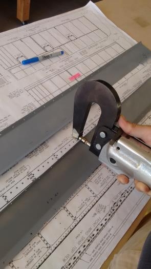

Brief Description:  Mark fairings with rivet sizes, dimple holes, clec

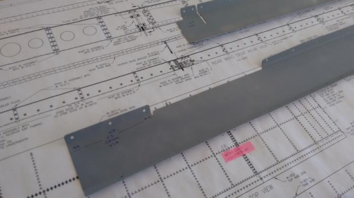

Double checking plans and marking fairings with rivet type and size. Three spar attach hole on flap fairing, at root, need to be dimpled for flush riveting. Rest of spar attach holes are AN 470 rivets.
All skin attach holes, skin and fairing, are same size rivets and dimpled.

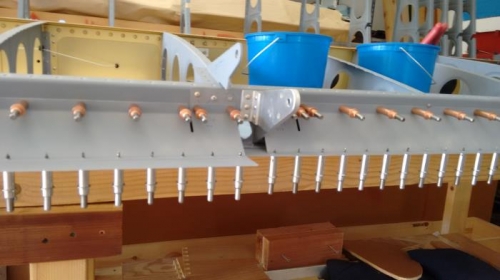

Cleco everything back onto spar / skin - check fit everything good.
Double check, mark
Double check, mark
Dimple
Dimple
