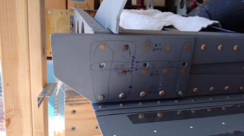

Brief Description:  Rivet 925 B & C to bracket and spar

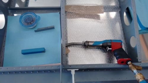

Cleco W925 C's to brackets - need to use rivet gun on bracket rivets - no room for squeezer.
Double checking rivet sizes
Right (outer bracket)
B uses 470 4-6 on spar side 470 4-7 on rib/bracket/angle
C uses 470 4-7
Middle Bracket
B uses 470-4-5 on spar 470 4-7 on rib/bracket/angle
C uses 470 4-7
Inner Bracket
B uses 1 426AD 4-9 and two 470AD 4-9 on spar, 470 4-7 on rib/bracket/angle
C uses 470 4-7
Short off set rivet driver

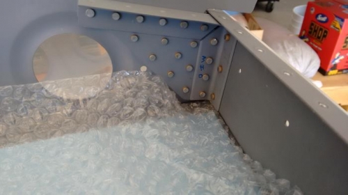

Inside view
Inside view
Last three rivets 2 flush one regular
