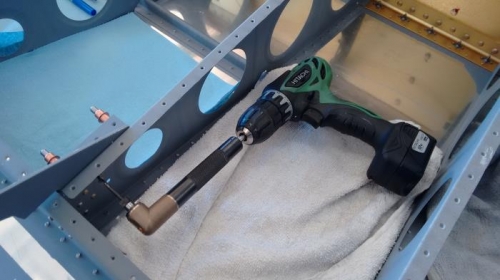

Brief Description:  Fit and drill W925 B & C to flap brackets
clamped and drilled B & C angle to flap bracket.
Used new 90 degree angle drill - NICE!

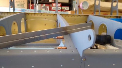

Verified top bracket (flush to bottom skin 925B) was flush between ribs.

ONLY way to drill these holes
Verify bracket is flush
