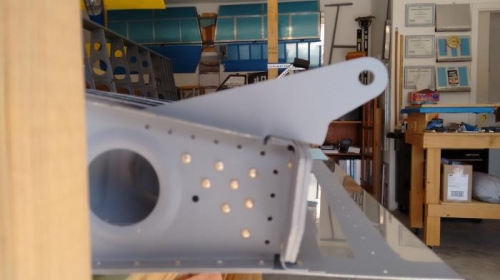

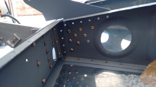

Brief Description:  Rivet Inboard and out board flap hinge brackets
Primed brackets clecos and riveting from front spar back to rear spar.
Using AN 470 AD 4-6 rivets

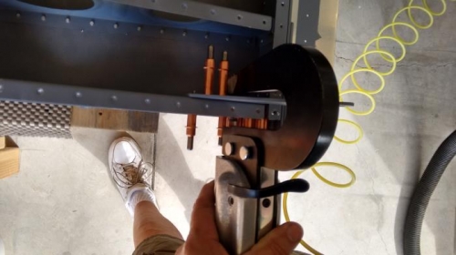

Used squeezer for all but last three rivets on outboard bracket nearest the rear spar - squeezer too fat to get a straight alignment.
Missed one hole drill out - drilled with angel drill and riveted
reaching in with squeezer
inboard rib/bracket
inboard rib/bracket
Outboard rib/bracket
