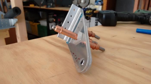

Fit parts together for W-913. Marked and drilled first hole in A-914 then fit it to W-913 assembly.
After figuring out how to temporally fit A-907 L (using plastic straw as spacer) and using it to align A-914 I drilled the second hole.
Second hole was more off center than the first hole. Aileron stop also turned a bit as was not as aligned as it could have been.
Decided to fabricate another A-914. Got it better second time. Holes very close to center and stop is aligned with A-907.
First hole drilled and aligned with A-907

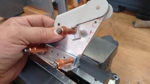

Using vise as brace to hold everything still
Final result.
Final result.
