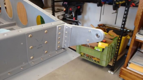

Brief Description:  Assemble W-914 and rivet to spar
Assembled and riveted:
Rivet flush rivets to hold bearing in place

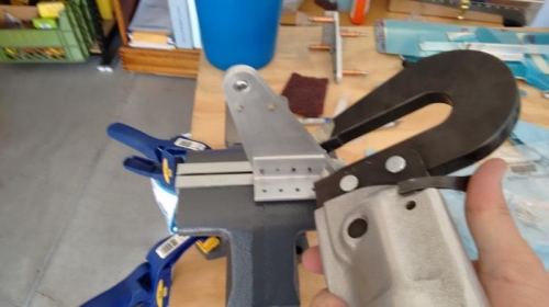

Fabricated a small reinforcement plate to provide backing for the W-914 to rib (on side) - I had drilled a couple of holes for the attach bracket to hold the wing to the uprights too close to where the bracket to rib holes were. One actually overlapped. Clamped in place and drilled out with bracket / rib step.
Riveted W-914 to rear spar and side rib.
Flush rivets to hold bearing
Riveting angle to W-914 assembly
W-914 Aileron bracket riveted to wing
