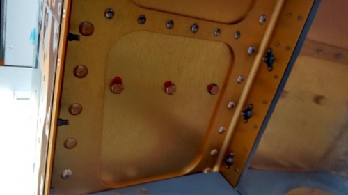

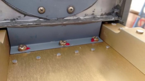

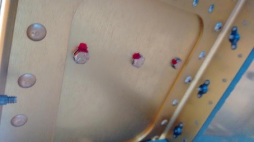

Ordered new AN 3-4 bolts to replace the original - they had been used 2-3 times installing tank on spar. The first time was pretty hard and they helped align nut plate / hole / bracket. But it took a lot off some of the bolts.
Installed new ones and used fingernail polish as torque seal / marker
new bolts on top of spar
Set underneath
Set underneath
Last set with 'torque seal'
