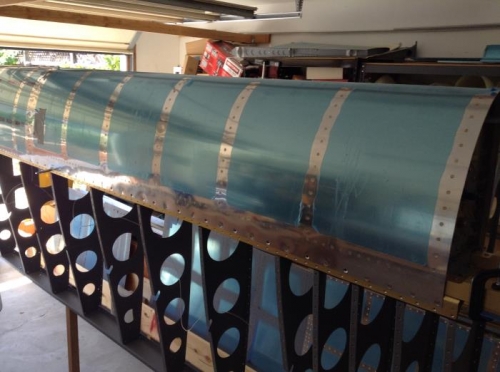

Brief Description:  Rivet CS holes spar to rib under fuel tank
Missed setting 16 rivets that have to be in before mounting the fuel tank.
Set 5 last night but bunged up two. Drilling out two this morning.
Removed inner wing skin/doubler to get other 6 on top and to make getting tank bolts easier to reinstall.
Double checked and double counted - all correct rivets squeezed properly.
All back together and clecoed ready to rivet inner win skins
