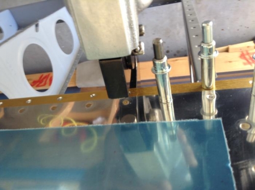

Brief Description:  Setting remainder rivets (105) skin to spar
FINALLY got the hang of setting the rivets holding the pneumatic squeezer upside down and braced between my arm and body.
Squeezed 105 rivets and only one drill out.
Originally started pre-squeezing rivets to 'plump' them up for a tighter fit. About a quarter of the way through I got the rivet squeezer mojo: breathing, bracing, and slow squeezing.
squeezer braced and ready

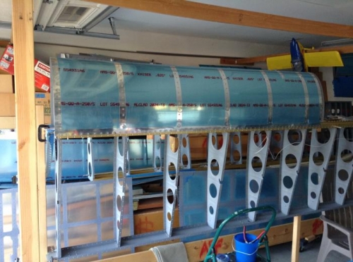

skin rivets all complete

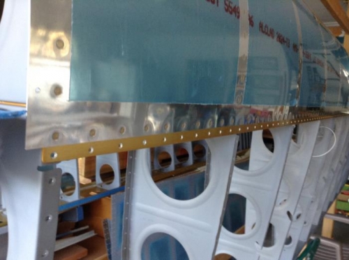

Leading Edge on wing!
