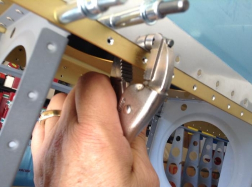

Using hand dimpler on holes that need it - some rivets don't sit deep enough.

Hand squeeze dimple to get good nesting

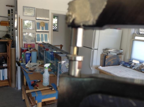

Tried pre squeezing to make rivet shaft thicker

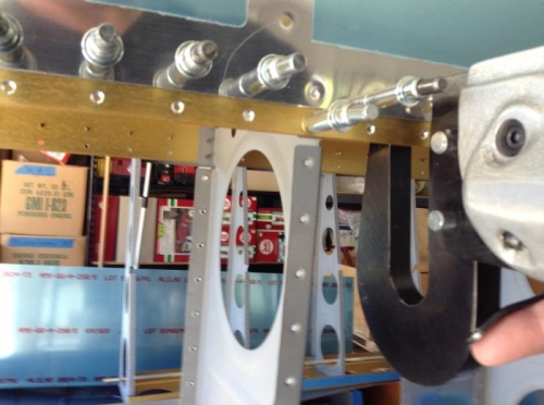

Bracing and setting rivet
