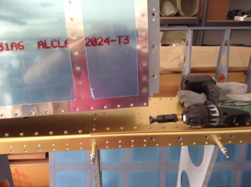

Brief Description:  Double checking all CS holes in main spar
Main spar rivet holes (3-xx) need checking. Some are not deep enough. Re-set counter sink and double checking each hole. (with test fits between skin and spar).
Ran cs through all holes.
Re-Alodined holes.
