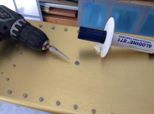

Test fit the Left Leading Edge Assembly. It appears that some of the rivet holes for skin to main spar are not quite deep enough. Going through to make sure - in some cases its a skin needs to bend down more to achieve a good fit. Double checking all holes

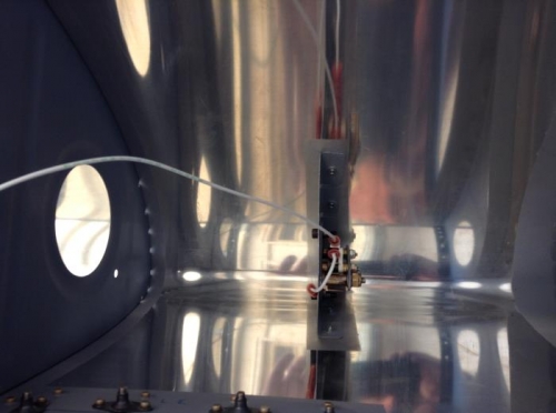

Also drilled hole in main spar for stall warning vane / wire (leads to instrument in cockpit)
Wire that needs to go through ribs/ spar
Hole drilled and alodined
