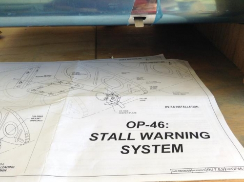

Manual Reference:  Stall Warning Syst
Brief Description:  Install stall warning bracket / vane system

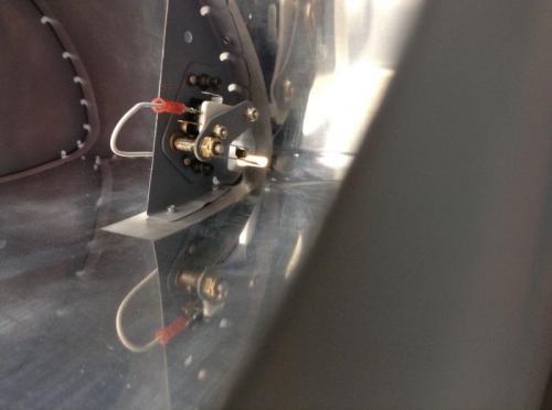

completed assembly of stall warning system. Constructed wire (crimp) and installed and tested for continuity.
Installed bracket assembly with pop rivets.
Double checked vane alignment, made small adjustment.
Bracket installed (pop rivets)
Vane adjusted
Vane adjusted
