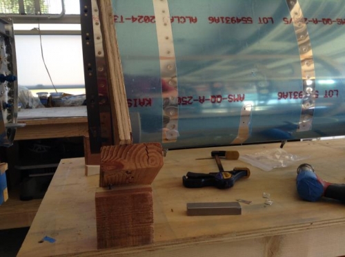

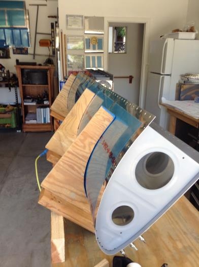

Riveted the foremost rivets in LE. Tilted up forms to be able to get to rivets that were "under" the curve of the leading edge. Worked out well.
Final rivets nearest the leading edge were a challenge to get bucking bar in proper align / placement. Tungsten bucking bar was a REAL HELP!
Forms tilted and screwed to bench to keep from moving
Final LE rivets made me work
