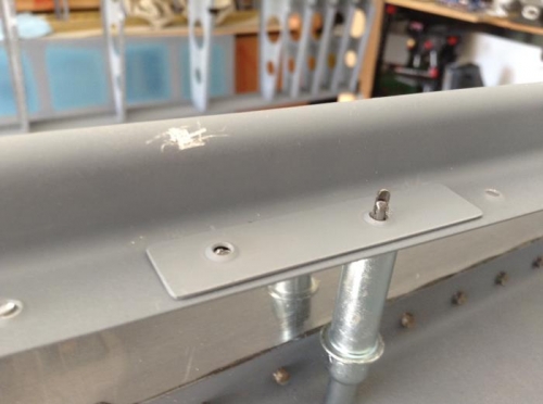

Brief Description:  clean up top inner skin, dimple doubler, dimple st
Score and peel plastic off top inner skin, clean up holes and outer edges.
Install nut plates on lower inside skin (1 drill out)
Dimple doubler and lower inside skin.
Un-dimple 7 holes - holes need to be UN dimpled for later install process.

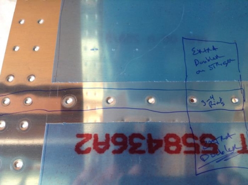

Dimple stringer - one hole bunged up by over active / twitchy finger on squeezer. Fabricated doubler (and primed) for messed up hole - just past where stringer overlaps. Marked and will two longer rivets when installing / riveting to skin. same size as used on overlapping stringers to skin. Marked plans and skin holes "3-4 rivets"
