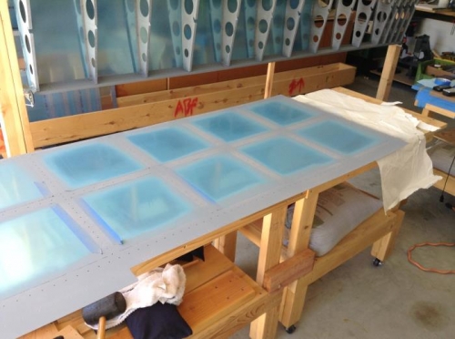

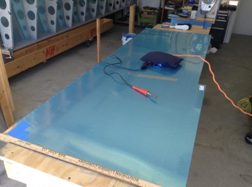

Scribe and remove plastic (out side of skin) to prepare for dimpling. Dimple holes in LE skin with dimpler and squeezer (edge holes).
Fit, drill, deburr, prime doubler and access plate for stall warner.
Install 10 nut plates on doubler. Held nut plates in position by installing screws - gave nice tight non-slipping fit. Held doubler in one and squeezer in other. Worked well all rivets nice and flush.
scribing plastic to remove
Inside primed and ready to dimple
