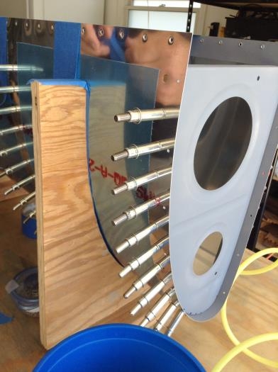

Brief Description:  Re assemble ribs / skin left leading edge
Clecoed rib to skin. Had to start with one cleco in first hole top of skin then pull skin over rib to get first hole in bottom of skin. (Actually pulled skin/rib down to bottom hole.
Once first two holes were set then gently inserted assembly into forms.
Remaining clecos went in easy.

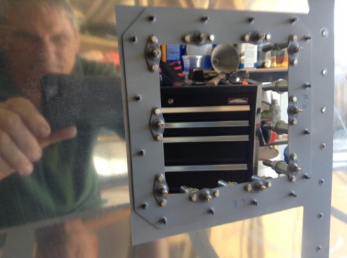

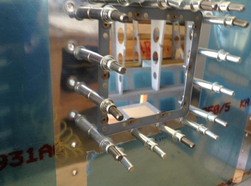

Also clecoed in the attach plate for the inspection cover (for stall warning assembly)
in forms clecoed ready for riveting
attach plate / skin doubler clecoed in place
Rear of attach plate
