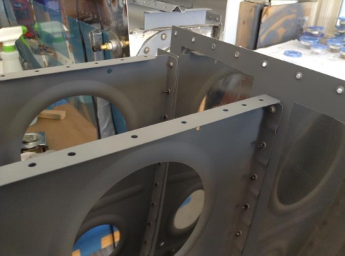

Brief Description:  Squeeze trailing edge of ribs to LE skin

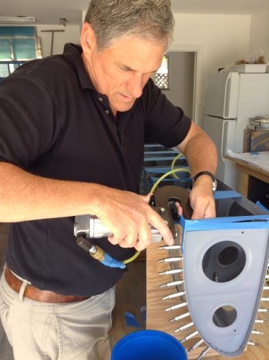

Taped trailing edge of LE skin to pull skin tight to ribs.
Used squeezer to set aft most rivet in each rib. Skin/W-919 splice plate / rib took 3-4 rivet. Skin/Rib takes 3-3.5 rivet.
Used squeezer with dimple dies to re-seat the dimples in skin to rib. Wanted good contact since skin wanted to angle away from rib (until tape pulled things together). Nice flush results.

CAREFULLY squeezing first rivet
Good tight flush fit
