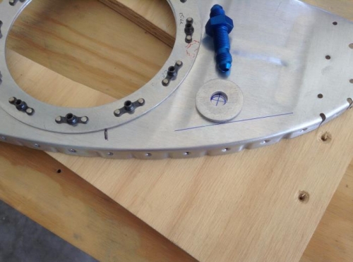

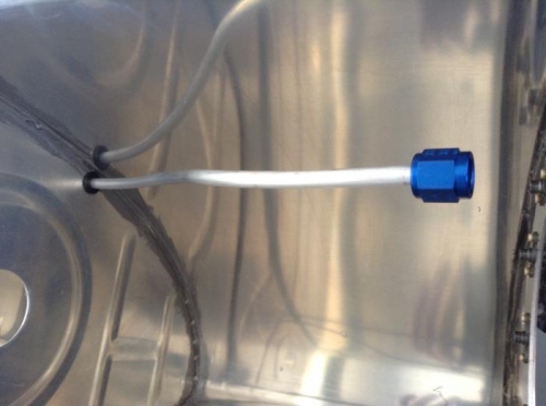

Brief Description:  Figure out plumbing for left tank
Marked and drilled hole for tank vent line. Measured and cut / bent fuel vent line. Used new flanger to flange end that connects to bulkhead union. verified fit and ready to seal in end rib. (discovered in time that the fuel vent line needed to be in BEFORE the rib. Also remembered the snap bushings that keep the line from rubbing against the ribs.
Hole marked
Hole marked
Drilled and bulkhead fitting test fit
Fuel vent line flanged and nut in place.
