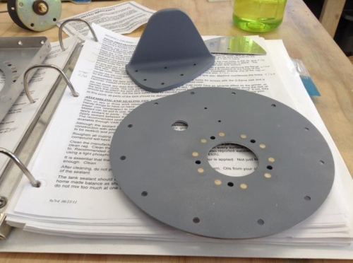

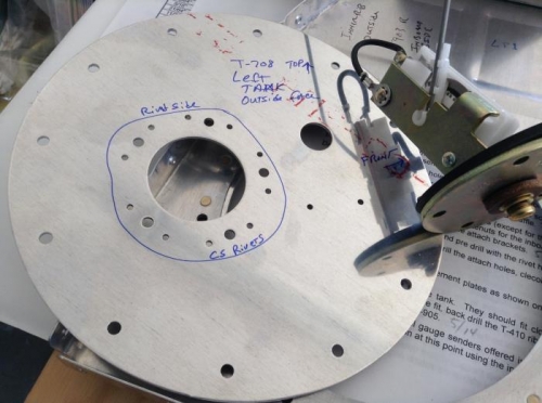

Need to CS and rivet nut plates to T-708. Fuel sender attachment!
Scotch brite and cleaned outside (inboard side) - scotch brite and cleaned T-905 also.
Primed both.
Riveting nut plates to T-708
Used Qtip with acetone to clean up overspray on inside of holes from outboard side (inside tank side) - tank sealant should cover these but just in case, to prevent possible fuel contamination.
Marked and double checked
CS with Drill Press
CS with Drill Press
Primed and nut plates attached
