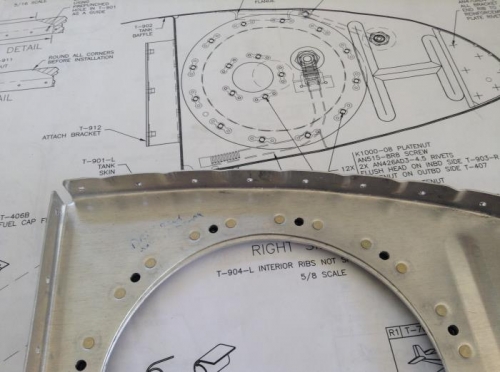

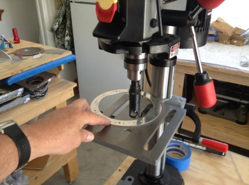

Dimple / countersink holes for nut plates in rib /
Dimpled rib skin for nut plate, countersunk reinforcement ring.

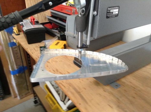

Used squeezer to rivet nut plate / reinforcement ring/ rib.
Nice and smooth.
