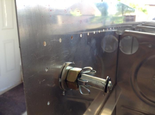

Center and drill rivet holes using drain flange
Created a 'centering tool' to hole drain flange in place. Worked out well.
Drilled holes and marked for reinstallation
'Centering tool' holding every thing in place
